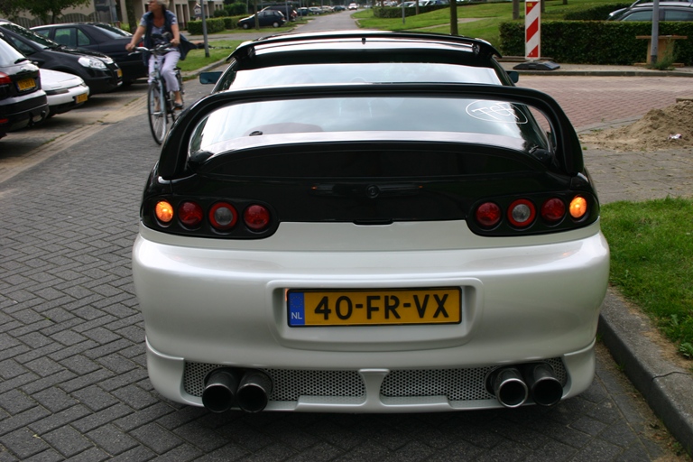

Bericht door mx3freak »
mijne:
even a broken clock gets to be right twice a day.
